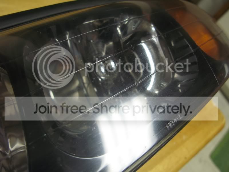

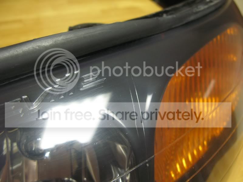

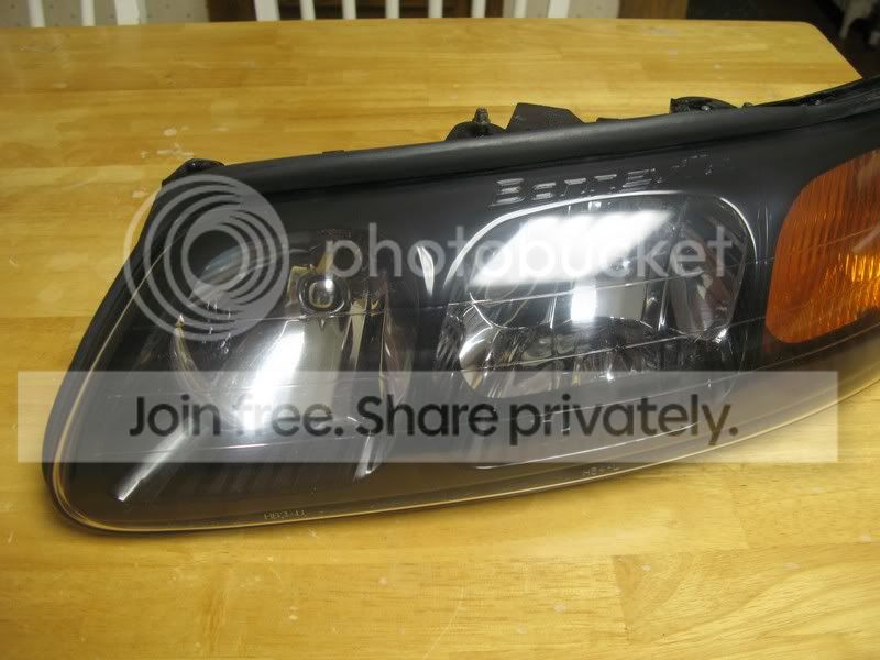

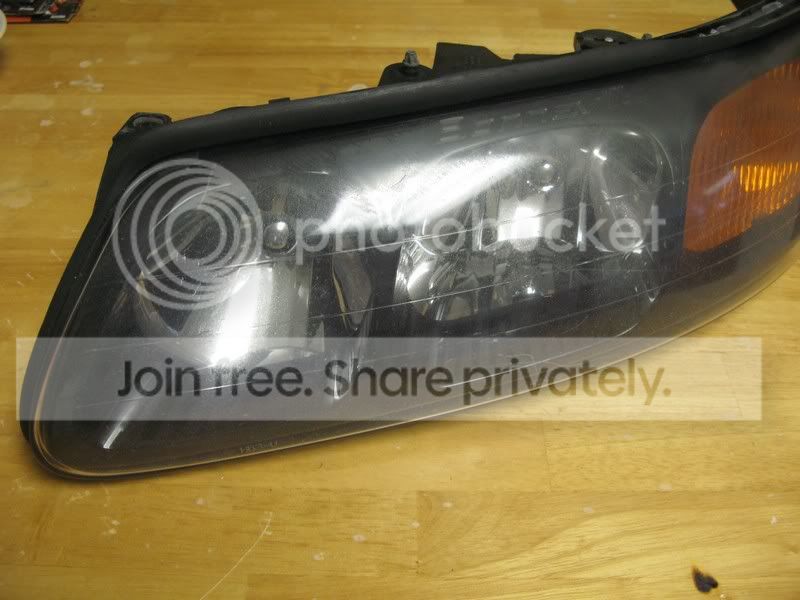

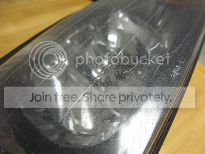

Headlight restoration tonight. Had to start with 150 grit to get out the deep scratches. Ended with 2000 grit. Still a few fine scratches, but looks 100x better. It would look better if I used some professional polish and buffer, but I only have a powerball and scratch-x.
Before:
After:
Before:
After:
Before:
After:
Before:
After:
Before:
After:
Before:
After:

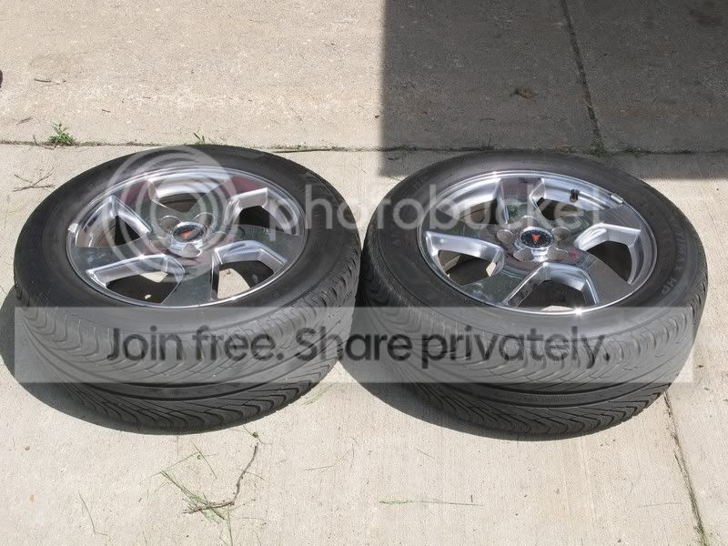

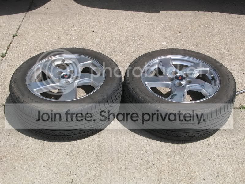

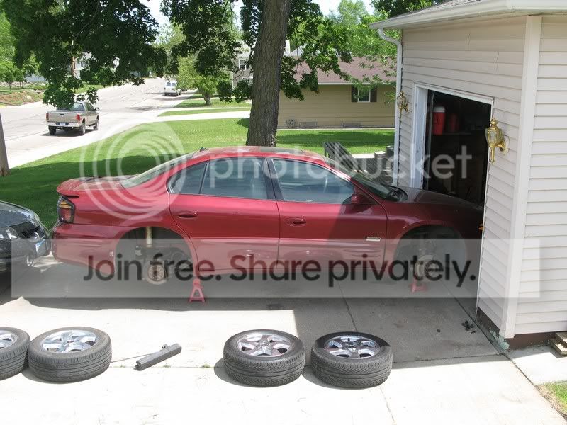

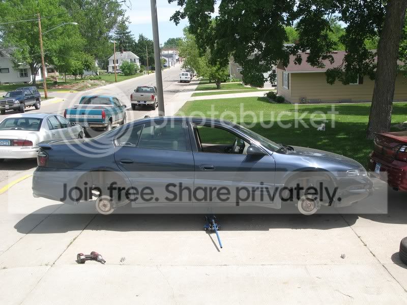

Today I fixed the door molding on the drivers door. It was coming off on the back side, so I used some 3M molding tape to put it back in place.
and then somehow, the 00 rims/tires ended up on the 03, and viceversa...
So now the 03 has the Pirelli PZero Nero's with 6/32nds of tread, and I have the General Altimax HP's with 8/32nds on my 00.
