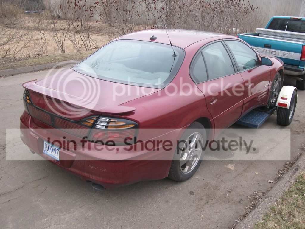

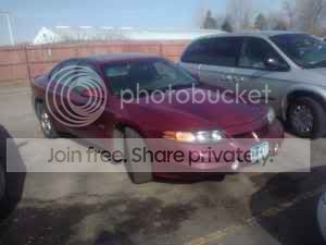

This popped up on craigslist and I had to snatch it up.
I have a 2003 Pontiac Bonneville SSEI in good shape, I put an engine in 8 months ago with 81k on it, it blew!! when I put the engine in I decided to find another transmission it no has around 90K and seemed to be fine. The car has General HP Altimax tires with about 15K on them. The car is in good plus, no tears, it actually is in pretty good shape, but you be the judge. I just want to wash my hands of it seeming my ex who blew it, and others....doesn't want to pony up for half the motor. (she was driving it)
This car is well worth it in my opinion, I just don't want to deal with it any more. ( I have papers on the transmission and can prove it was the actual miles on it.)
Before I get a ton of emails, yes the motor is shot, number two and four pistons are in pieces. I don't know what caused it but it happened. All of the accessories are in very good working order, that goes for the charger, the battery is less than 6 months old.
I am going to hold pretty close to the price seeming I can part it out and do okay. The suspension was gone through when the cradle was out and what needed to be replaced was replaced. It has a new fuel pump as well There is no broken glass and all the windows and sunroof properly, the radio works fine.
If you act quick, I know where there is a motor out of a 2002. I have a lot of $$$$ into this get me out of it!!! I have a clean clear title. I do not have pics as it is 20 miles away. It is Maroon in color with tan leather.

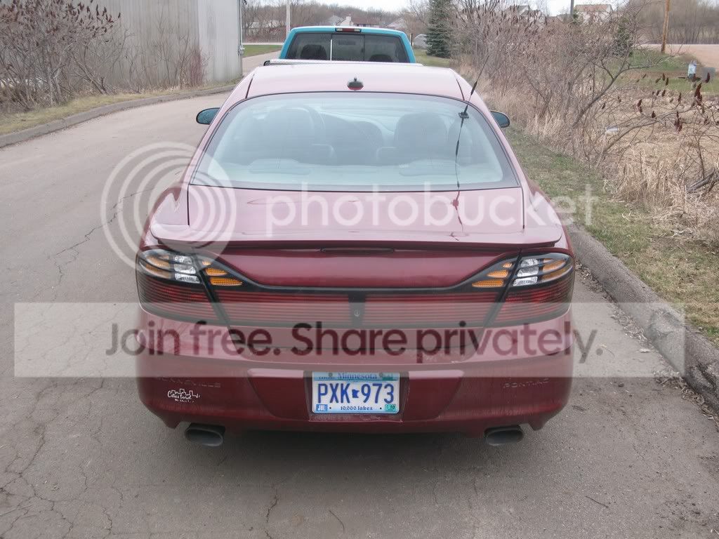

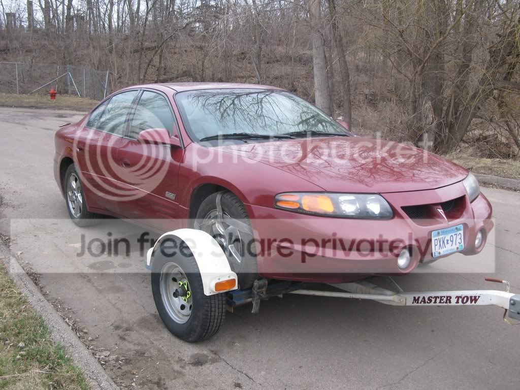

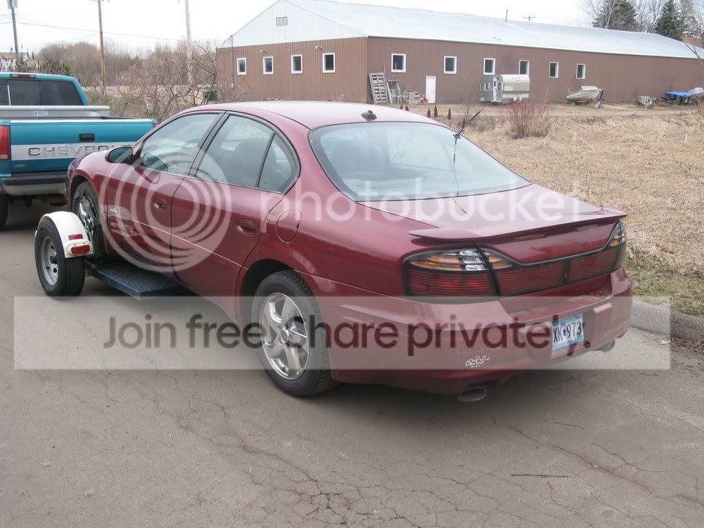

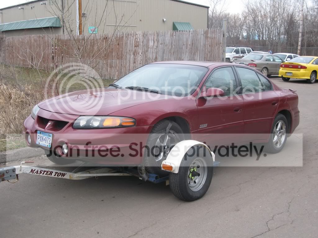

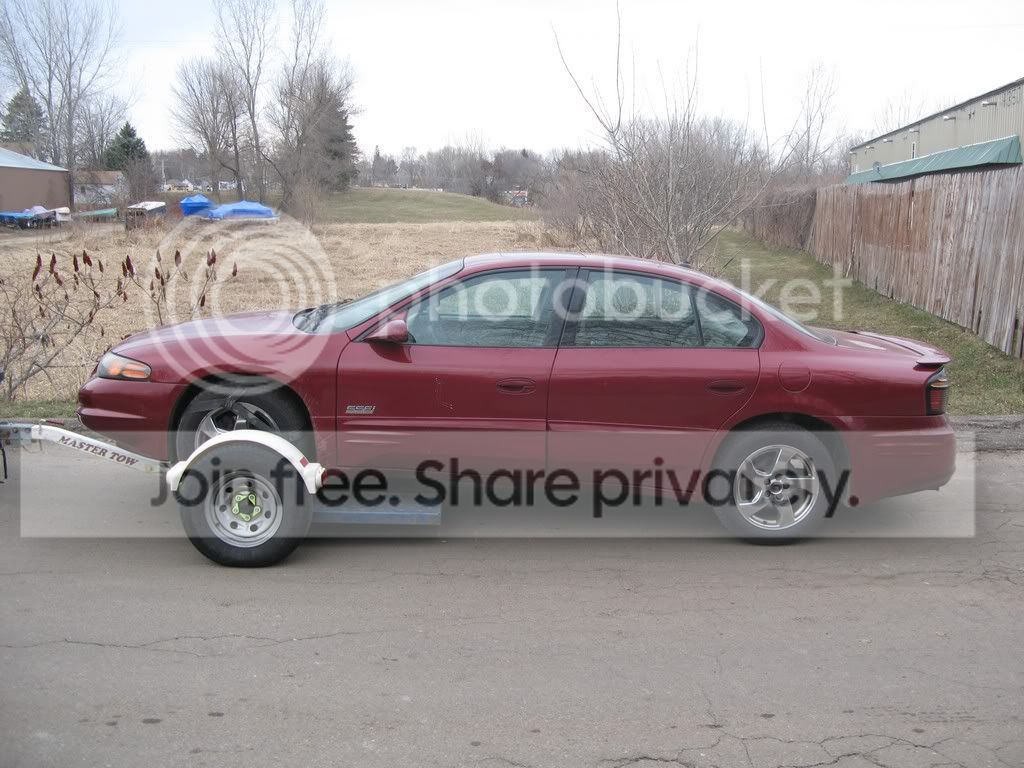

I drove down there this afternoon and picked it up. The funniest part was I had bought the first engine and tranny that had blown out of this car, so the guy was familiar with me, and that’s why he sold it to me even though there were tons of other people calling and even offering more money (Marty? LOL).

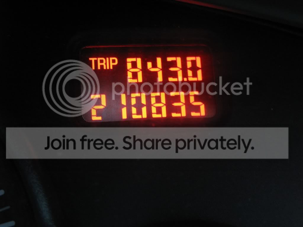

What he didn’t say in the ad is that it has high miles… 210k ouch

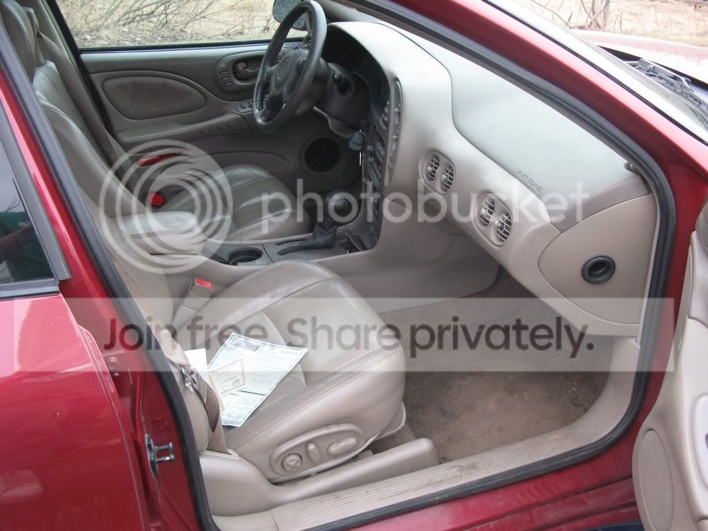

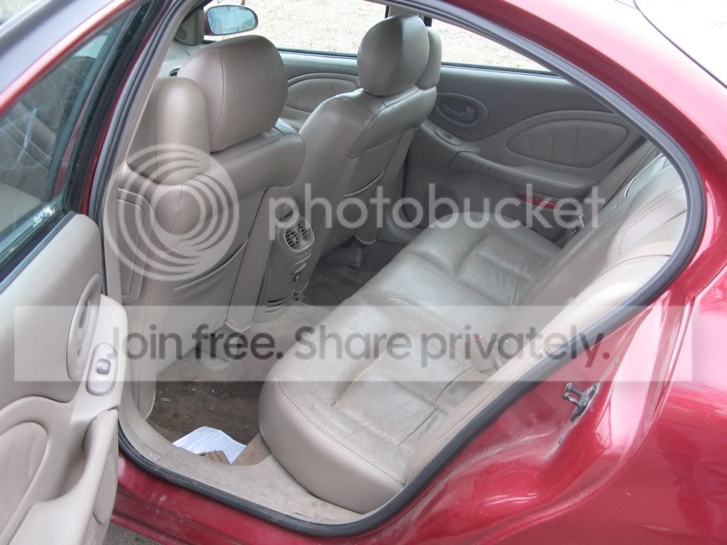

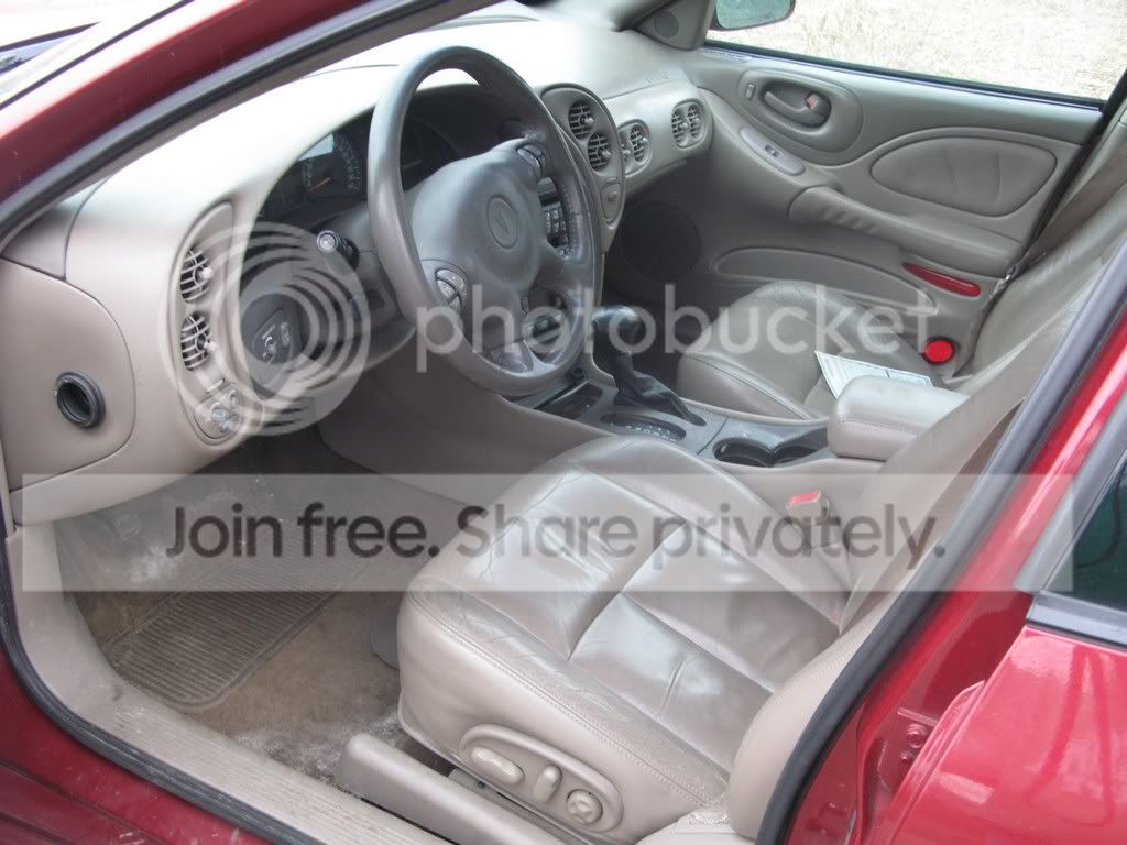

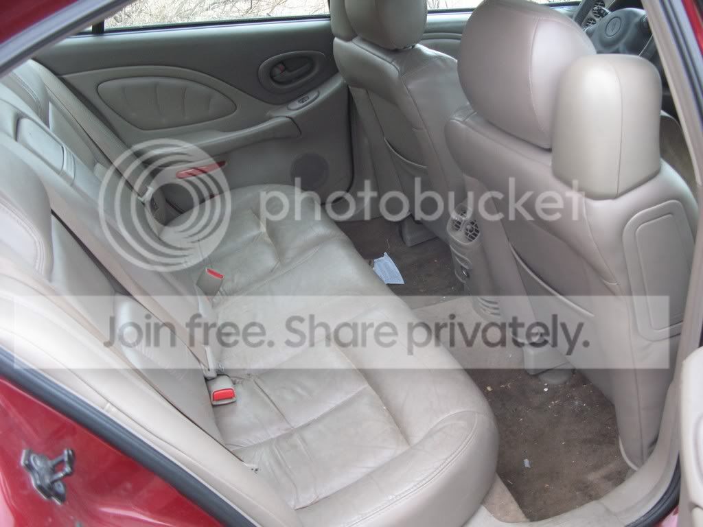

The interior is pretty discusting, but I have new carpet and door panels for it, so I’m not worried. The exterior is near mint except for some bubbles under the gas door. It has no hood herpes. I will be fixing it, not parting it. And if you didn’t catch it from the ad, I only paid $1500.

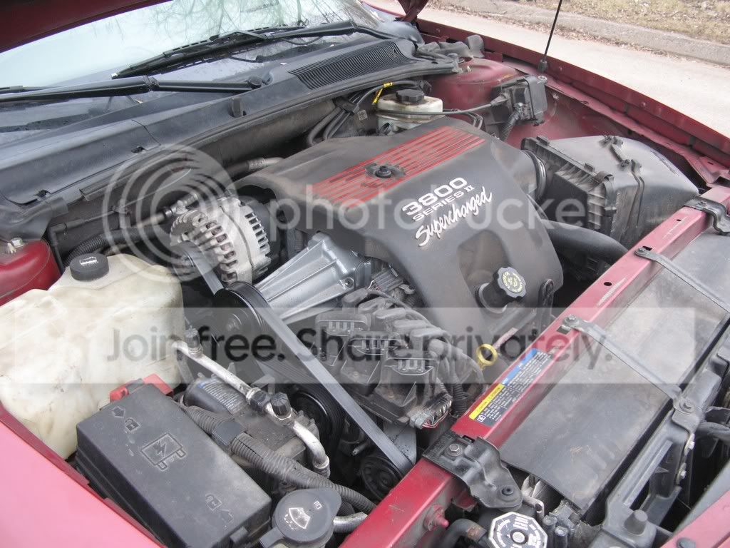

They claim the engine is shot (the owner and mechanic). When I went to pick it up, it was at the guys mechanics shop. I arrived there before the guy, so I was talking with the mechanic about it. He said it was making some noise, so he pulled the spark plugs and #2 and #4 were all messed up. He claimed that since the 3800 is an interference engine, that it ate itself alive. I mentioned to him that it is not an interference engine, but he stuck to his guns claiming he has worked on a lot of GM engine and he knows it is. I didn’t argue. However, this makes me wonder, what is actually wrong with this engine? They claim popped pistons. I’m gonna remove the valve covers and do a compression check before I yank the motor out. Who knows, maybe its fixable. Anyways, onto the pics.
My biggest concern is, who is going to buy an 03 with 210k on it?

Maybe its just because I'm looking at low resolution photos of the car, but to me that interior, even the driver's seat leather, looks really good for 210K.
1997 SSEi | Bright White | 170,000+ Miles | Stock | Best 1/4: 15.374
Re: project: 2003 SSEi
Black Pearl wrote:Looks like all the options but a sunrooof. Nice score
Actually does have the sunroof. You can just barely make it out in the first pic.
Water 97SSEi wrote:Maybe its just because I'm looking at low resolution photos of the car, but to me that interior, even the driver's seat leather, looks really good for 210K.
The seat are amazing for 210k. They are dirty, but no tears or wear. The only major problem with the interior is the carpet and drivers door panel.

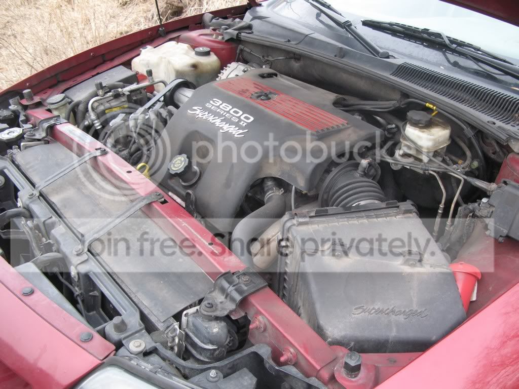

If it did pop the pop pistons again, it's possible that pieces from the last one were sitting in the cat, and got sucked back in. It doesn't happen a lot, but it has happened.

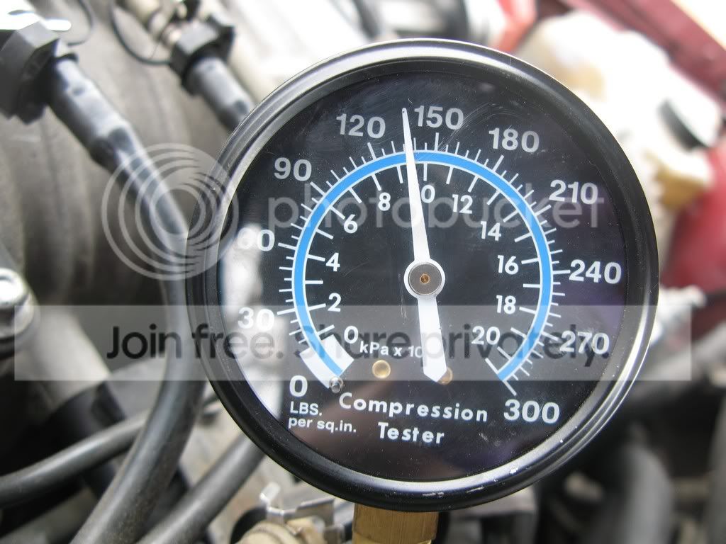

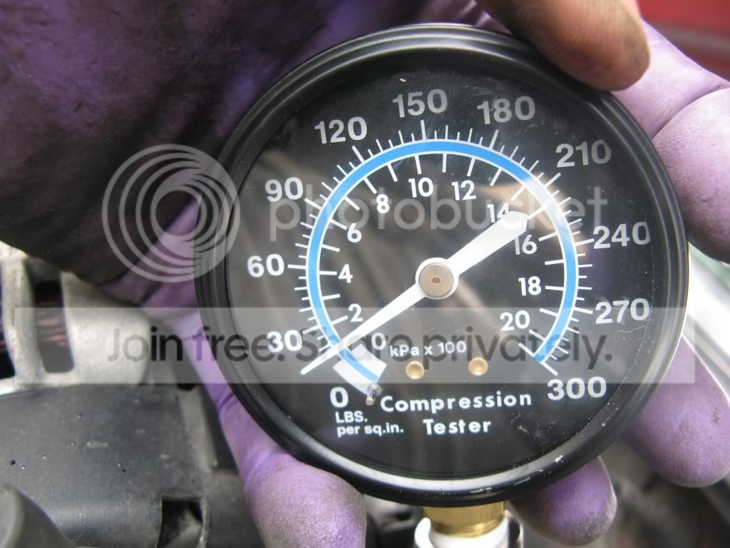

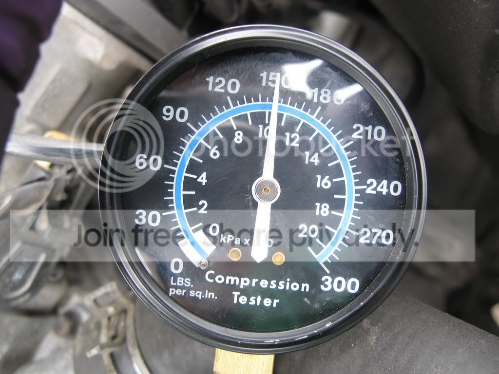

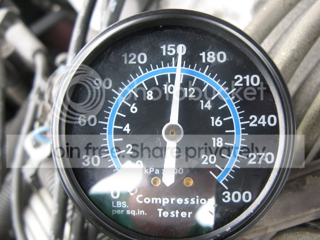

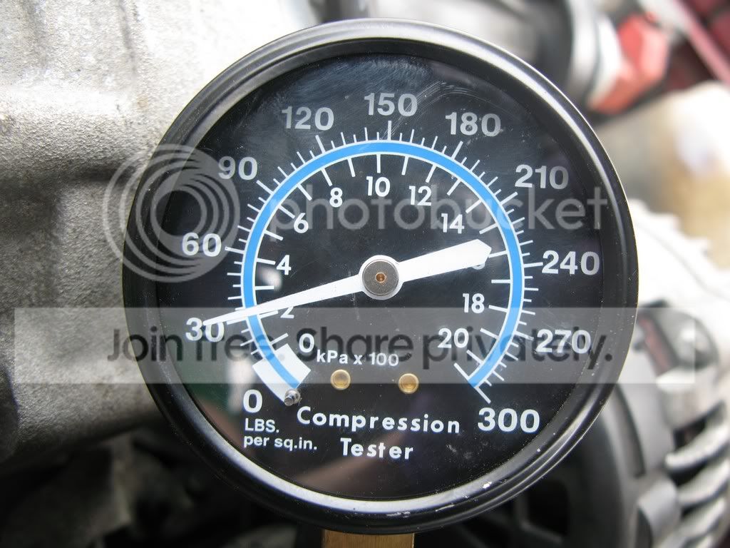

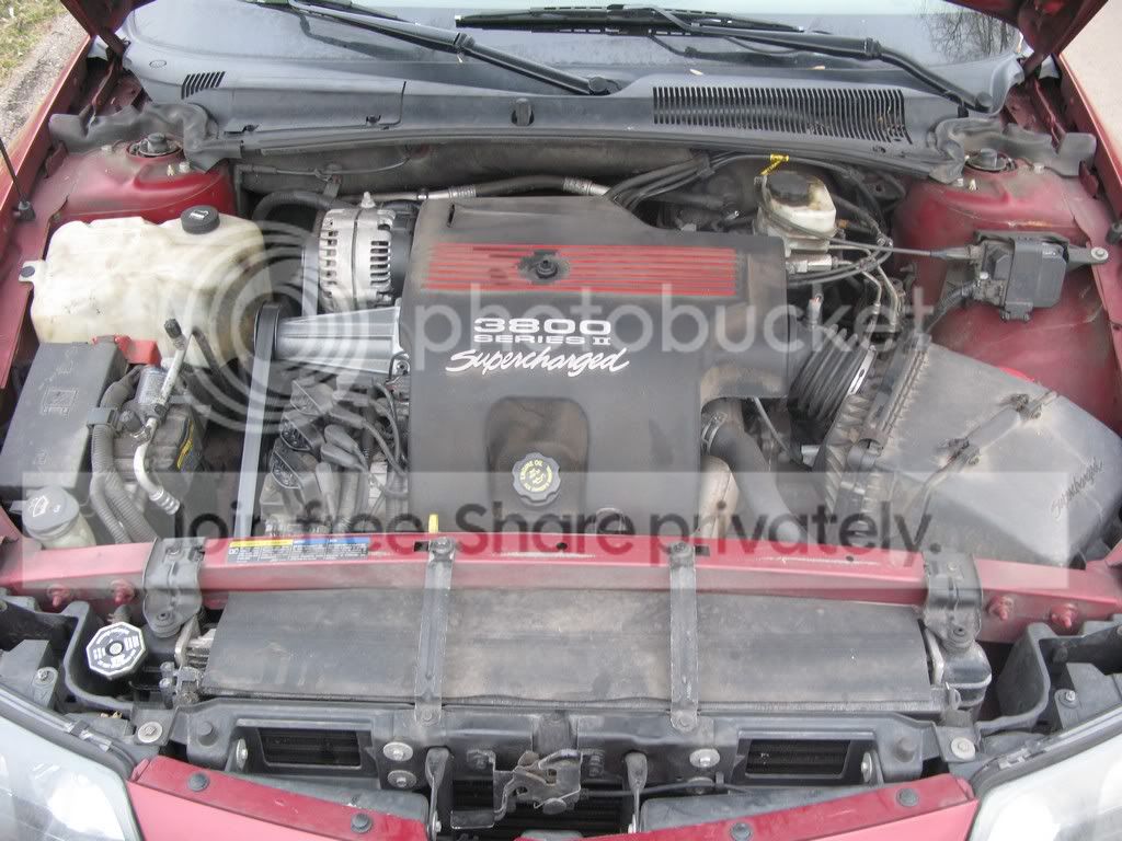

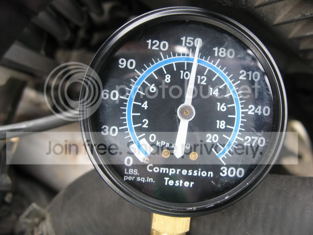

Just did a compression check to confirm the problem. Yup, its got a problem with #2 & #4.
#1
#3
#5
#2
#4
#6
I really wish I had a borescope to look around in there, but at this point, its going to have to be taken apart regardless. It either does have popped pistons on 2 & 4, or the slight chance that the head gasket blew (very slight).
I'll be removing the rear head to inspect the damage. At this point, I'm thinking instead of dropping a new engine, actually replacing the pistons.

I think you might have the compression pictures mixed up, cause it shows 4 and 5 to be low....I'd say get the engine out and see how bad it is, then you can decide which route to take.

You're right, my bad. I tested front bank and then rear bank, so 1, 3, 5, 2, 4, 6.
I'll be taking off the rear head before I take it out of the car.
