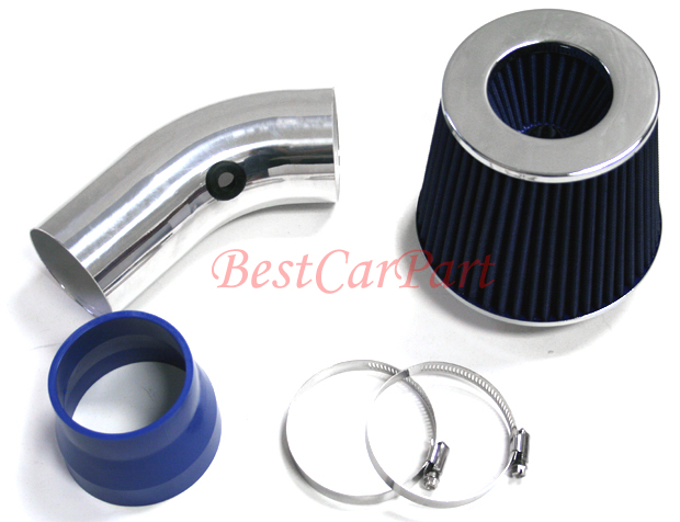

Which air intake would you get?
Would you rather get this one:
http://cgi.ebay.ca/PONTIAC-BONNEVILLE-F ... dZViewItem
or this one:?
http://cgi.ebay.com/ebaymotors/ws/eBayI ... OTORS:1123
or this one:?

bonnevillain
- Posts: 3046
- Joined: Wed May 21, 2008 11:07 pm
- Year and Trim: 2002 SLE
- Location: Minnesota
Re: Which air intake would you get?
both of those (specially the first) have a sharp un-needed bend, and horrible filters.

Lewis, that won't fit an L27. His TB is smaller than yours. He'll need to use the 3" FWI tubing, not the 3.5".
I agree that both kits posted above are garbage. Just about any CAI on ebay is.

lewis26
- Posts like an L27
- Posts: 699
- Joined: Thu May 22, 2008 6:31 pm
- Year and Trim: 2003 SLE || 51k miles
- Location: West Lafayette, IN
Getting a cold air intake that sucks up warm engine air is probably worse then the stock airbox. To make a cold air intake effective, it has to actually intake cold air. That is the best part about the intense FWI, that it sucks cold outside air from the fender.
The one you have posted will be sucking hot air from around the engine, and in my own opinion would be a complete waste of money.

- Allmachtige
- Retired Moderator
- Posts: 3975
- Joined: Tue May 20, 2008 9:24 am
- Year and Trim: 2009 G8 GT
- Location: Aurora, IL
That pic your posting is sucking up hot air when the car is moving. The ONLY way (unless you fab up a very well insulated system that gets cold air directly from the outside) to suck in outside temp air it to put the intake outside the engine bay, and the fender is the perfect place.

- harofreak00
- Administrator
- Posts: 26022
- Joined: Mon May 19, 2008 6:04 pm
- Year and Trim: 2004 GXP - plus a handful of other Bonnevilles
- Location: Browerville, MN
Your engine heats up the engine bay pretty fast. Ever felt your hood after running the car for a while? Just because there is a small amount of wind coming in, that air is still heated. Why else would GM make an air box that leads directly to behind the headlight? Why wouldn't they just put the filter directly on the throttle body? Your best solution is a FWI. I find that my FWI is always within 10* of ambient temps.
