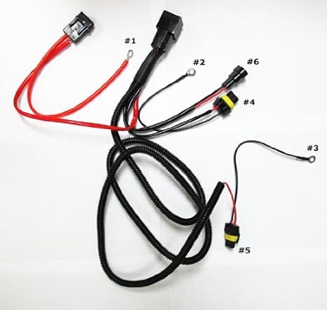

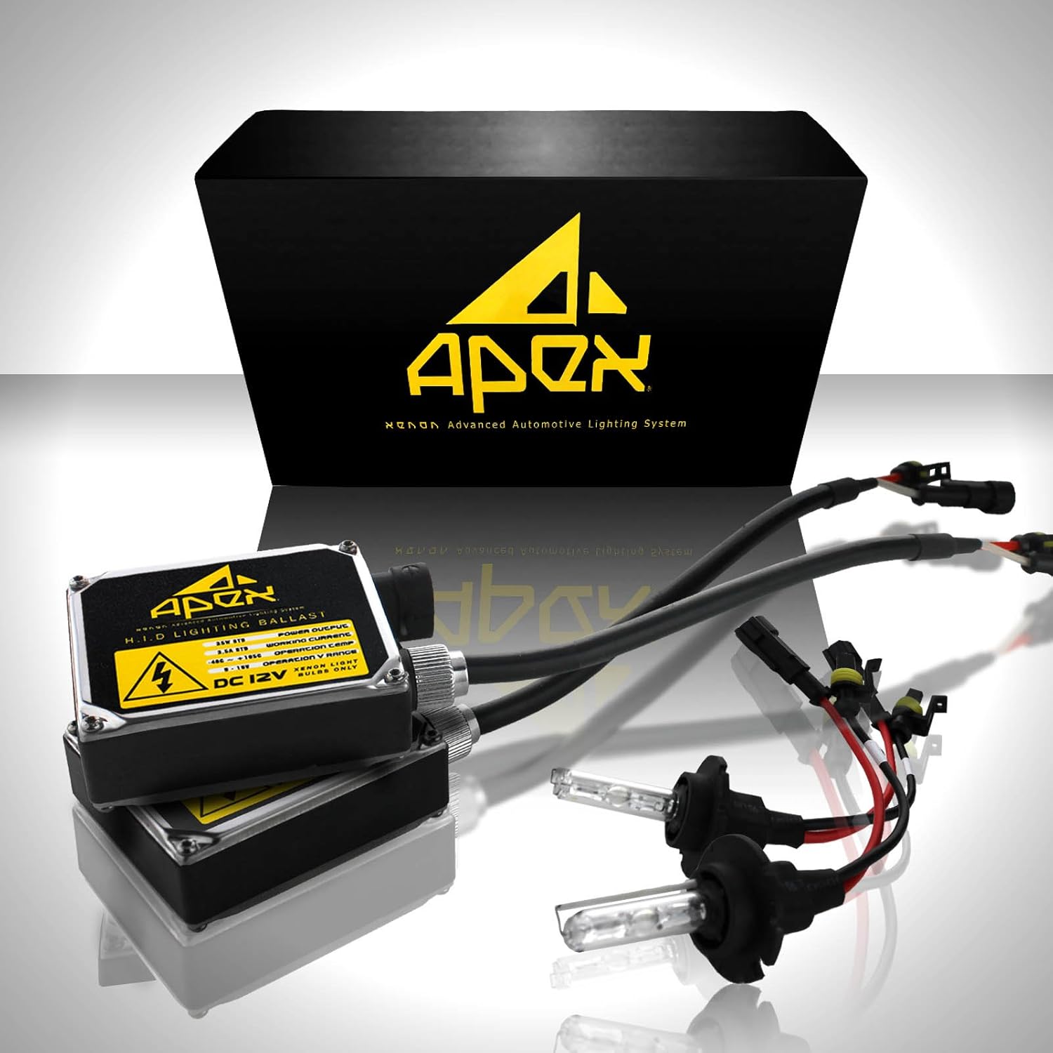

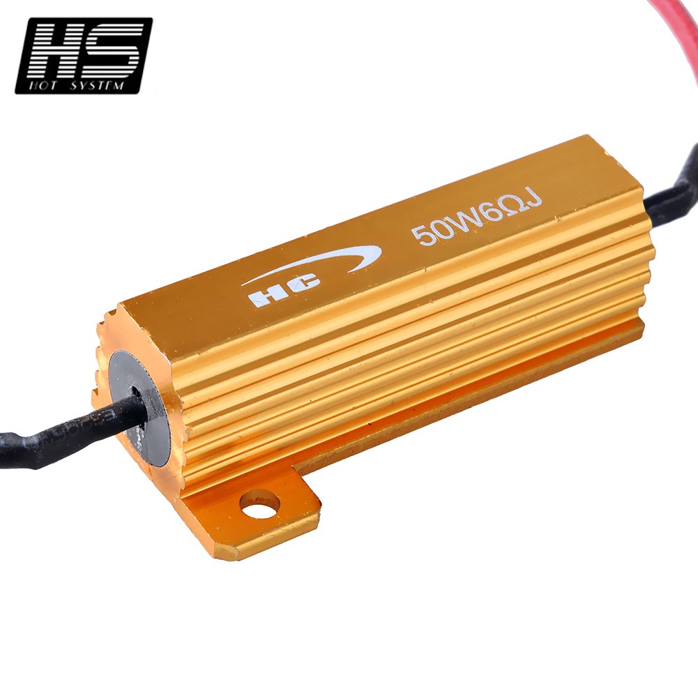

Hey all, I plan to update and modify the entire external lighting system to HID and/or LED.( Stage 1 ) I will start with the front headlights first and have already purchased 35w 6k diamond white headlights and 2.5mm mini projectors and Power wire harness relay for direct power to power source and reduce HID flicker on start up. This will be for all my low and high beam headlight needs. I plan to keep my 9005 socket but upgrade to a LED for DRL and Highway lane change flash key-fob alerts , etc . I also plan to upgrade the turn signal to 3057 amber leds as-well. All led's will be running on there own 50w 6ohm resistors.
Stage 2 I plan to upgrade the factory fog lights with HID bulbs and 35W ballasts 6K diamond white running on there own power relay wire harness .

Wiring's and resistors bought:
9006 harness Headlights: $8
LEDS: $2 each total=$8

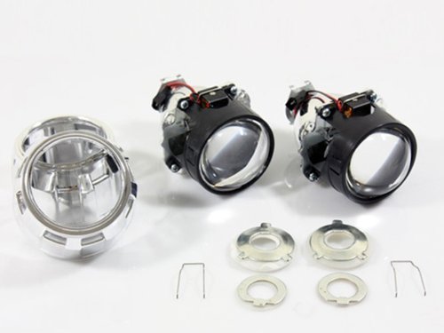

Nilight® 2.5" MINI HID BIXENON PROJECTOR LENS $42
Apex H1 Xenon Hid Conversion Kit ( 6k 6000k Diamond White ) $29
Apex 880 / 881 / 899 / 893 Xenon Hid Conversion Kit ( 6k 6000k Diamond White ) $29

Projectors are mounted and i have done a aim alignment . Will report back with pictures. Took all dam weekend ! :sadeyz:

I used JB weld Instead of bolts because i wanted to aim mine when letting the jb weld cure for ultra alignment. This is the stuff i used and once mixed together and placed on back of projectors and sandwiched on you have 3 minutes to align it and it sets fast .

Re: Project Total Retrofit
Beautiful. The Steelstik is so much easier than bolts, just requires greater accuracy. I love that more people are going the retrofit route.

better pic of cutoff
2001 BONNEVILLE SLE (Galaxy Silver)
2002 BONNEVILLE SE (Galaxy Silver) (DD)
Cutoff looks quite good for what appear to be some generic H1 projectors.

Yes! I can not complain for the price, They are generic and was told they our knockoffs of Morimoto Mini " the Oringnal Gen 1 "
But , the originals are better of course . if you got the $

Update :
The 6K projection beams are NICE and adjusted good not one person flashed me after i went projector. Plus i see like 5 times better! :beerchug: :beerchug:
