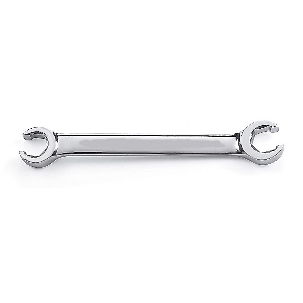

Are the lines leaking or is the Modual? Make sure you use Line wrenches to remove the lines to prevent them from stripping. Not just a regular open ended wrench.
