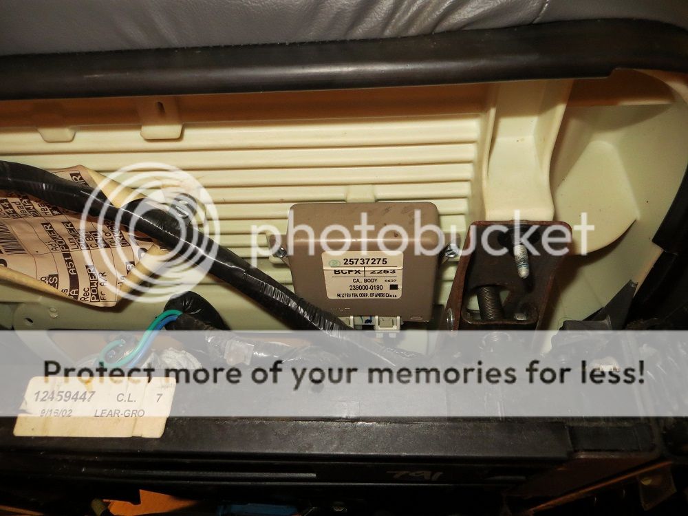

Does anyone know how to replace the control module for the drivers heated seat?

Unbolt the seat, tilt it back and it's underneath, attached to the bottom.

You wouldn't by chance have a picture of what I'm looking at would you? Can't say I've done work on a seat before so this is definitely going to be new to me...

Here is a picture. However, please understand that most of the time you can learn more by doing instead of just asking.
