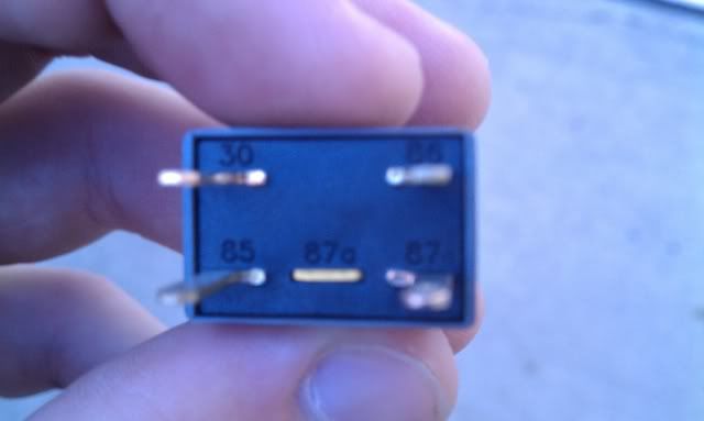

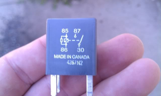

Hey Guys,
I have been trying to disable my DRL's for awhile now, but I have run into a problem. I have a 2005 SLE which happens to have many wiring scenarios which arent the same as other SLE's. For instance, my car runs the low beams for DRL's, not the high beams. This leads to my question/concern. When i pull relay 30, its only a 4 prong relay, with no center prong for the 87a. I know a "standard" SLE you just jump the 30 to 87a and your done, and supposedly this should still work on my car...BUT...within my fuse box, there isn't any contacts to insert a wire into the 87a hole (this can be seen below).....
So my question is..how do i Disable my Running Light? My thought would be to jump my 30 to 87...but im leary to try this since i could mess up something.....
ANY thoughts or suggestions are welcome!

Just for the heck of it,, pull the headlamp high beam relay. What does that look like? That should have just 4 terminals. I'm wondering if your car is wired like a GXP that shows using the low beams for the DRLs.

Thanks for the reply and suggestion. I will pull that relay when i get home and back by the car. I will get back to you on that one. If this were the case (wired like a GXP, and high beam relay has 4 terminals) what is the process of DRL's? (if you know, i see you have a 2000 SSEi)

Post by yonkerse »
Hey Archon,
Well you nailed this one on the head, i pulled the high beam relay and my Running lights are now disabled! So i guess this tells me my car is wired like a GXP so i should know to check that section possibly on other wiring scenarios. Thanks a ton for the suggestion that was able to solve this head ache for a couple weeks now.
Also thanks to all others who have helped along the way and offered suggestions!!!
