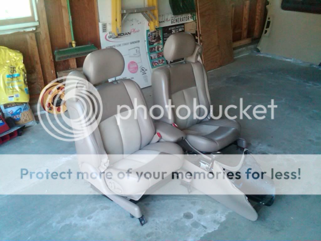

Ok, got the seats out; phew. They were heavier than I expected. You guys must be a lot beefier than I. Let me paint the picture...I'm 6' 2", 150 lbs. (Can you say beanpole?) Anyway, tried to get carpeting out but it appears to be held by the center console. So now what, are you going to tell me that has to come out too? If so, it may have to wait until next weekend - before I run out of light I need time to get the seats back in so I can drive it to work tomorrow. Let's make it easy - what all has to come out to get the carpets out? :helpsmilie:

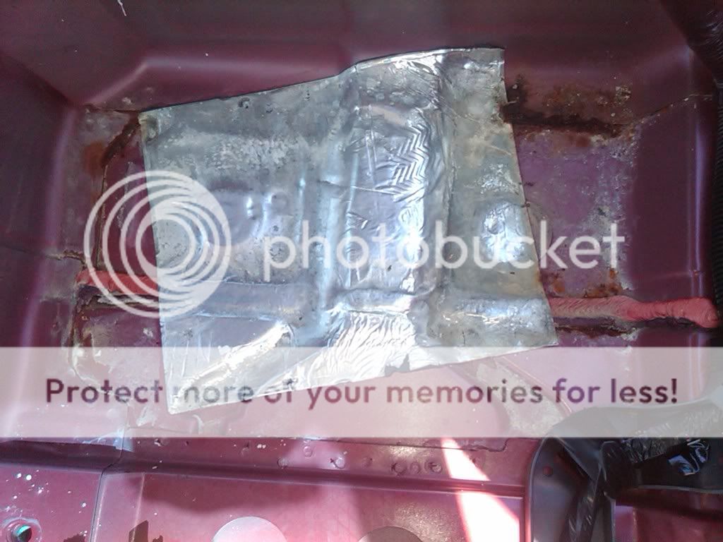

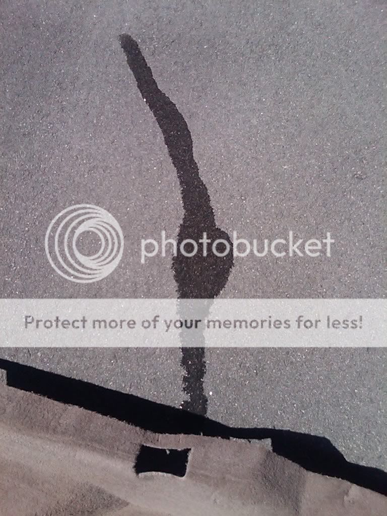

Finally got some good weather on a weekend, so I managed to get the seats, console and carpeting out this morning...
What do you guys use to clean your carpets. I wonder how our Haan Steam Cleaner would work on it?
The 'sponges' on the underside of the carpeting on the driver's side were soaked.
I stood on them to drain most of the water, then turned them over to let the sun do the rest.
No rust under the driver's carpet, but a little on the rear floor.
Do I need to be concerned as long as I fix the leak?
Under the carpeting I found build manifests for about 8 consecutive VINs after mine.
Interesting that they'd leave all that paper under the carpeting.
