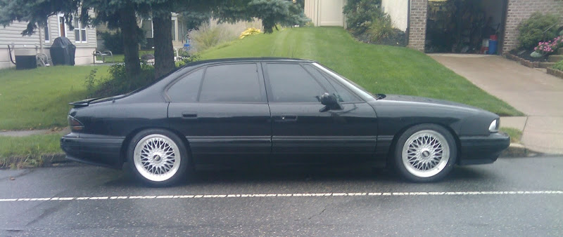

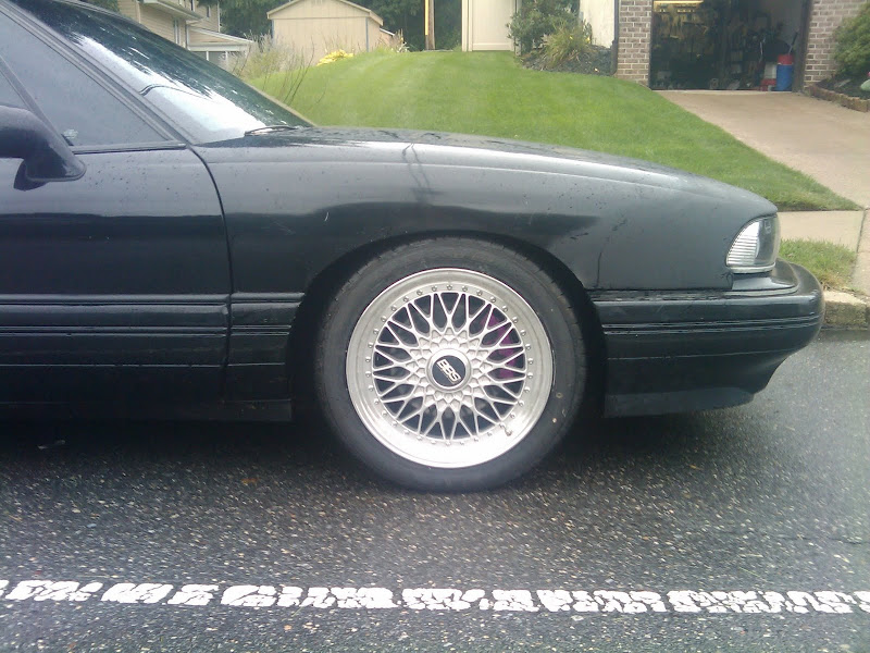

I haven't had much time to work on the bodywork but some new wheels came in the mail.
They're 18x8 and 18x9 3-pc BBS Super RS'. I had them re-drilled from 114.3 to 115 and the centers bored out from 66mm to 70 mm. I wrapped them in 245 45 Dunlop SP Sport Maxx's all around with the 9's going in the rear.
The offset on these was +42mm on the 8's and +50 (I think) on the 9's. My current offset is +22 on the GP wheels and that put the wheels pretty flush with 235 profile tires. I got longer ARP studs and 1/2" (12.7mm) spacers. I figured I would start from there with the 245 profile tires and add spacers accordingly.
I was able to get the 1/2" spacers and longer studs installed in the rear. But the studs on my aftermarket front hubs have a larger diameter where they go through the hub. I ordered the correct studs today and some 8 mm spacers to see how flush I can get the wheels. More pics to come once I get the fitment right.
Also, might go black on the centers while they come off in the winter. The lips will look like mirrors either way by spring.

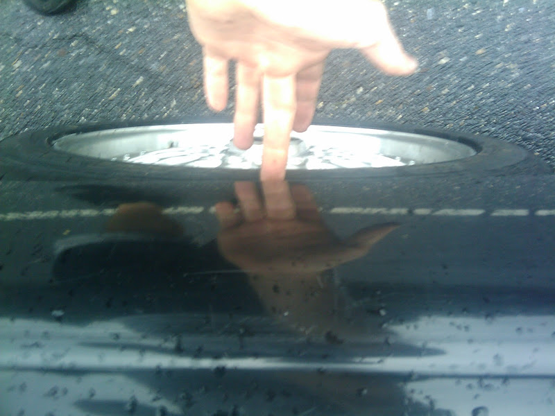

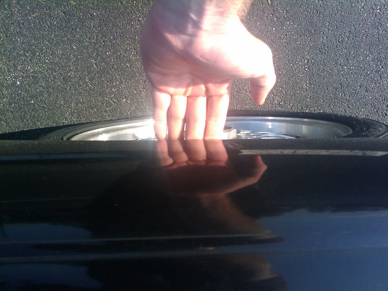

Here's what I'm talking about with the offset.
Granted the rears are 9", they only stick out about 5mm more than the fronts offset wise.
Here they are with 1/2" (12.7mm) spacers and a little bit of negative camber:
That's less than 20mm to the outside of the fender.

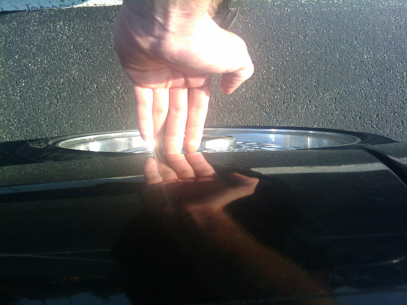

Here is how far in the front sits with less (numerically higher) camber:
That's about 40mm till the outside of the fender.
I would like to get the front and rear maybe within 15mm or so. I think it makes the fitment that much better.

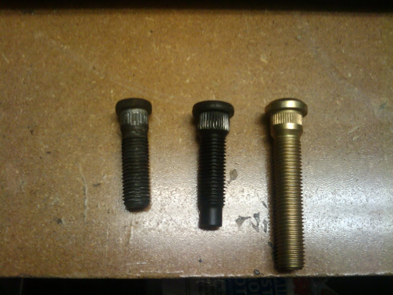

Here's what was going on with the studs. From left to right - Stock with 0.485" knurl diameter, From aftermarket hub with 0.558" knurl diameter, and longer ARP with 0.558" knurl diameter.
Before spacer:
After:
The wheel spacing is much better and almost where I want. The rears are a little more sunk in than the fronts though. I'll try the 8mm spacers out back there when I get them. I think an 8mm up front would be too much but its just a matter of trying these things out.

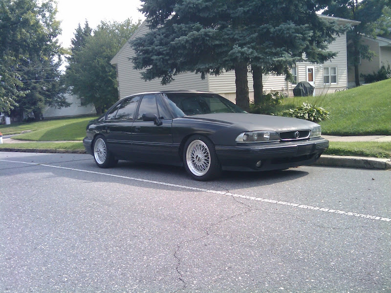

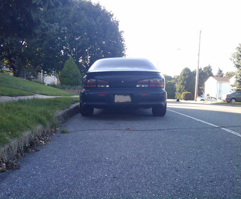

Installed 8mm spacers on the rear today:
I'm pretty happy with the rear fitment now. I'll probably try and trade a set of my 8mm spacers for a set of my buddies 5mm ones. (for the front)

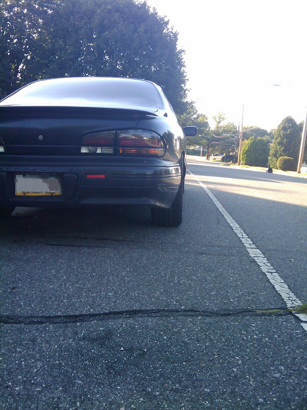

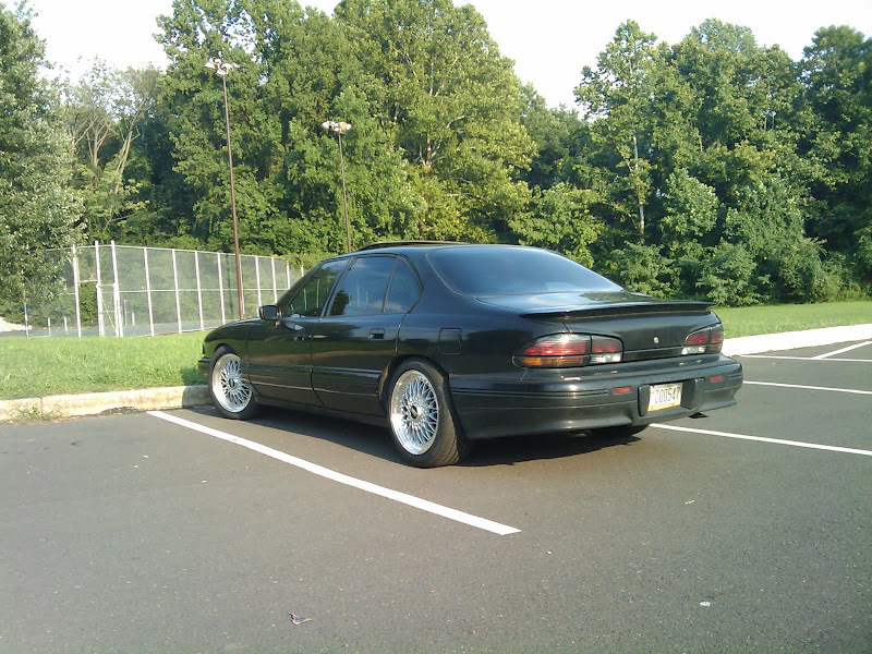

A couple more rear fitment shots:
