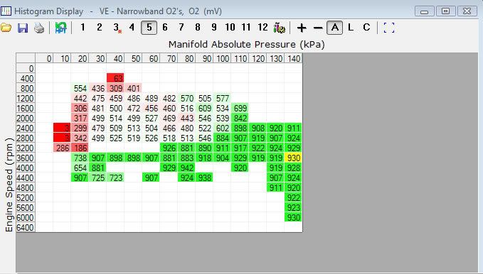

I command 14.7 AFR until 28%, then it hits 11.75. Just confirming, dunno if I'm confusing you or you are confusing me...probably both.
Main conclusion I'm coming to is that my O2's are not enriching after various 1% increase to my Hz range above 28% TPS (~6500Hz by the way). Resetting my trims didn't help with my O2's in the slightest. Maybe time will let them settle in.
I feel as though I need to add a good 2-3% to see if I get any results. Is this normal? If so this is the leanest running car GM has ever put out on the market. :eek2:
I'd give it 5% more and see if you can see any results.
Its a bummer you can't set up the histrogram so you can copy from the scanner, then paste special multiply by % in the editor.
Sorry, I haven't been able to look at the stuff you posted.
i'll try to do it today so I can help you set up a histrogram. When you have the option of copy from the scanner and paste special multiply by %... you'll get it dialed in - in no time.

It rained this evening so I wasn't in the mood to just sit their spinning the tires, but I did get a few accelerations that triggered partial throttle KR. First thought...my lean O2's are contributing to this. Second thought...I have none and need assistance.
BUT! O2's are looking better:

Don't make any changes based on data collected in the rain. The PCM can adjust to temperature changes and barometric changes, but cannot adjust to humidity. You'll only be chasing your tail again. On the flip side, it's good to see the O2's are getting up there. Once you get your O2's in range, start looking at your AE. I've already bumped my max delta up 50% and may need to go up more.
