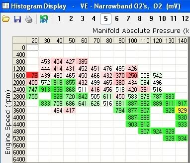

Through the HP Scanner, I'm seeing LTFTs at 2 in the far left column.
Should I continue to chase the last 2?

Yes. When the MAF is done right the only LTFT value you should see while in boost is 0...really the only LTFT values you should see are 0. Only then do you move on to getting your O2 or AFR values where you want them.99ssei wrote:Through the HP Scanner, I'm seeing LTFTs at 2 in the far left column.
Looking at the latest histogram (should've caught it on the earlier ones but I didn't) I see that you're getting into boost at very low engine speeds (1200-1600rpm rows mainly). My guess is that either the TC is locked up creating a high engine load, or you've done the BCA mod that allows you to get into boost a little quicker. Whatever the case is it's probably skewing your average LTFTs. Look through the raw scan data and you should see how the LTFT differs when, for example, the MAF reads 8500Hz @ 1600rpm vs 8500Hz @ 3200rpm. When the new MAF table is created, data for both cases would be used even though there is an abnormally high engine load at the lower rpm.
Also, it looks like you're collecting data while decelerating from high engine speeds (20-30kPa column gives it away). That data is garbage too and can throw things off if you use it. If you set the Fuel Trim Cell as one of the parameters to scan, you can filter the data by it. Toss out anything with an FTC of 0 to get rid of any data collected under regular braking, or while engine braking after a quick sprint.
Any chance you could upload the .csv file of the raw scan data somewhere it could be downloaded? A quick run of that through some spreadsheets and software I have should highlight any potential trouble areas.

I meant the far right column (under boost), sorry.
That's really good information! How do I know if the TC is locked up? What's a BCA mod? I'm guessing Boost Control Actuator? I'm positive I haven't touched either. If this helps, at anytime, I can make KR jump if I stomp the gas pedal hard while at cruising speed (doesn't really matter what speed). This has always been an issue. I've just learned to downshift before stomping the gas.
Tonight I will look into logging MAF data in Hz and adjusting the FTC so I stop capturing deceleration data.
I can upload the file, but don't know where. Maybe I could send it direct? Send me a PM. Thanks!

Really all of the cells in the histogram should read 0 if the tune was perfect, but close to 0 is good enough. When your LTFT locks in right though you should see 0's in every cell where the MAP is reading 100kPa or higher, that's a must before you move on to other parts of the tune.
You know those annoying times when you're cruising down the highway and give it a bit of gas to pass someone, only to find that the engine really isn't revving even though you're at half throttle? That's the torque converter locked up...it'll do it in 3rd and 4th gear up to a certain speed or rpm. I usually start scanning in 3rd gear at highway speeds to avoid lockup altogether. If I'm at a lower speed I pop the throttle first to unlock the TC, then roll on it for the scan. If you're cruising in 4th, downshift it to 3rd and the TC will automatically unlock. You want to do the majority of your scans in 3rd gear as it offers the best resolution. 1st and 4th gear scans are usually avoided.

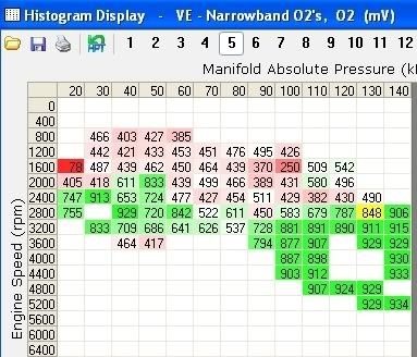

Okay, I'm a bit stumped.
It was 74 degrees & low humidity here. I have my LTFTs in good range, however my far right side are now -2.
Looking at my O2s, I'm not between 930-940. If I'm running a bit rich in the upper end, shouldn't my O2's confirm this?

Your O2s will be all over the place with the narrow band. I've seen mine go as low as 880mv with an 11.5:1 commanded AFR. What concerns me is how low the O2s are in the 100-130kPa range. My guess is that your PE enable throttle position is set too high. Try setting it at 35% for all engine speeds 2800rpm or higher and see if that clears it up. If your scanner is recording the MAF in Hz I could get you a more exact PE enable point.

Looking at the scan your O2s while in PE mode are almost spot on. As expected the PE trip point was too high so the pcm was still alternating between rich and lean, dragging the average down. From the data it looks like your PE enable point should be ~30%. The program wasn't happy with the .csv file so I couldn't get you a better estimate, but that throttle position should be good for most situations. Expect the LTFTs to move around some once the new trip point is put in.
Edit: Just got the new scan. Looks much better with minimal KR, O2s are back up to 915-940mV for the most part. Still getting into boost around 30% throttle so I'd still drop the PE trip point a bit more. If it bogs or kicks in too soon for your driving style you can bump it back up at the lower rpm's.

What are the O2s and IPW doing when you get KR?

Hitting 5.0 KR..same scan from above:
A little bit later in the scan, KR hit 6.2:
