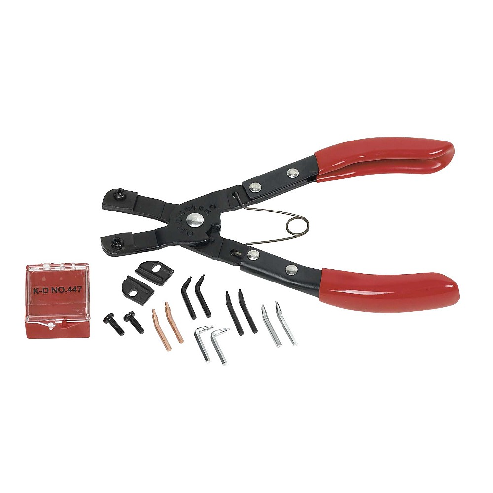

Trying to get that snap ring out now...it is a PITA!!!

These make it easier.
