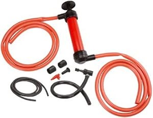

I do what imadozol does to get 75% fluid change. Use this $10 hand pump, available at almost any place that sells auto parts (pump comes under various brand names, but they are all the same):
Drawing the fluid out through the dipstick tube gets rid of almost all the mess when dropping the pan, and eliminates the need to drop it a second time to reach 75%. Use the skinny black hose attachment to get down deep into the trans.
