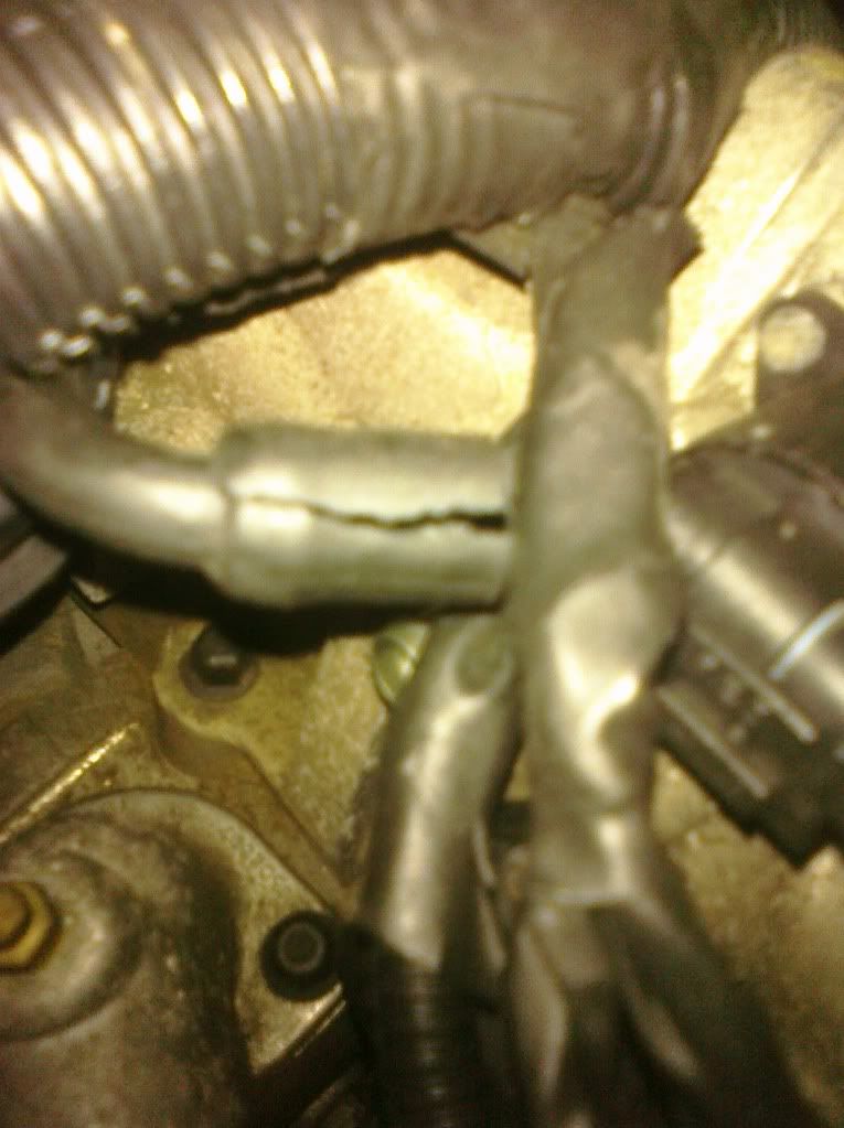

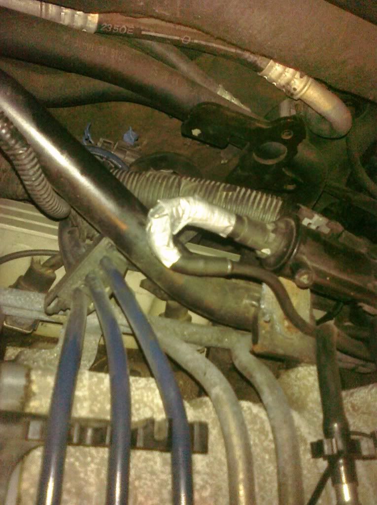

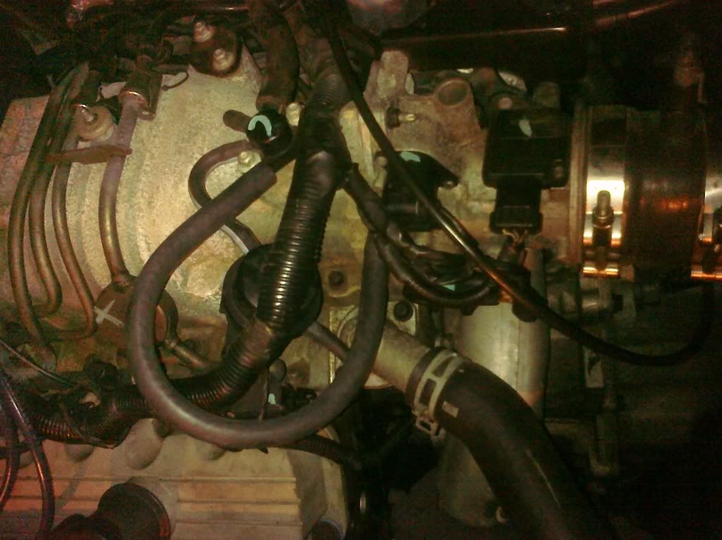

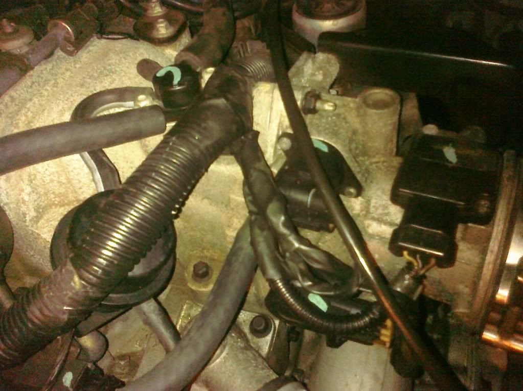

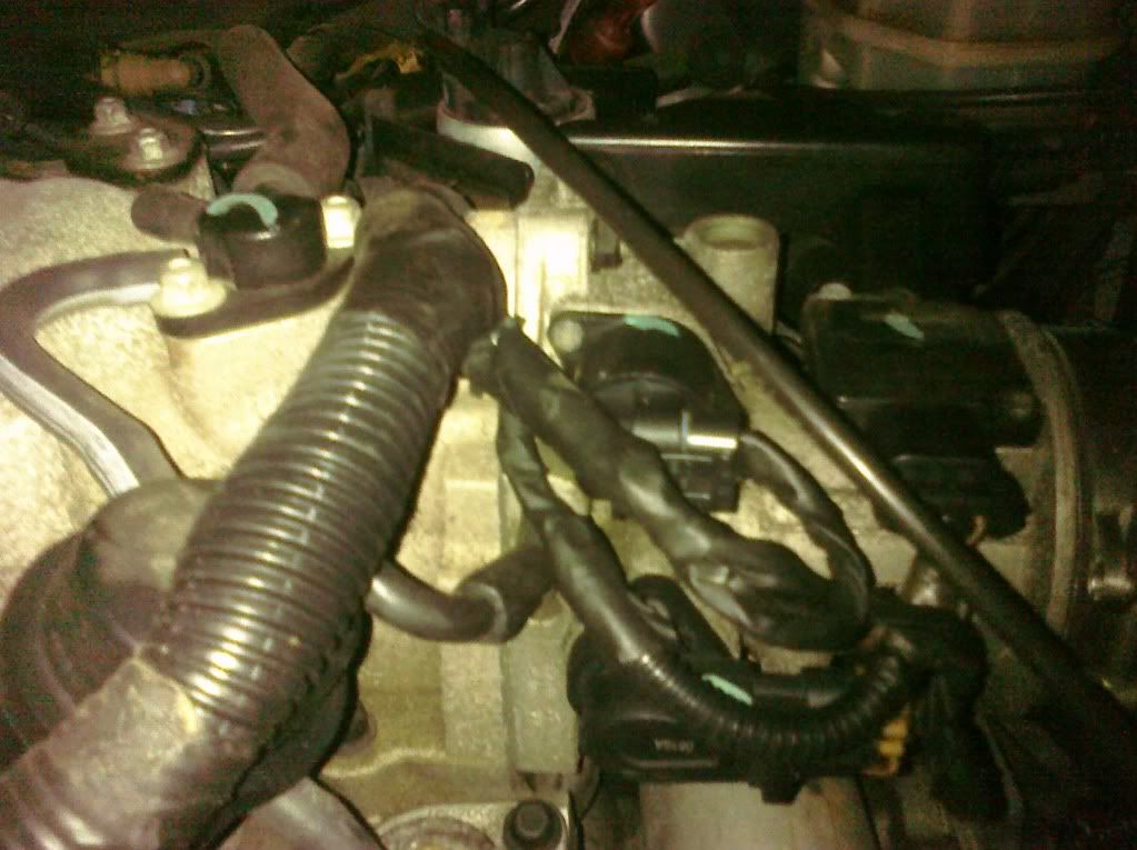

Finally got to pop the hood last night. As soon as I lifted the hood I could hear it and then it only took a few seconds to find it.
I just used what I had at hand in the toolbox to make the initial fixes.
The more I moved this tooobing the more cracks I found. I got some new toooobing at Advance today and I'll replace the whole thing.

I replaced a lot of my vacuum tubing with the bulk tubing rolls you can buy at the parts store.
- Posts: 20960
- Joined: Tue May 27, 2008 10:30 pm
- Year and Trim: '17 Silverado 1500
- Location: MN/IA
Re: New problem.
Andrew and I had to use a heat gun to expand a piece of smaller tubing to fit on that fitting on the TB when mine broke off. Dealer wants like $17 for it, and would have to order it. It hasn't bothered me enough to replace it.
