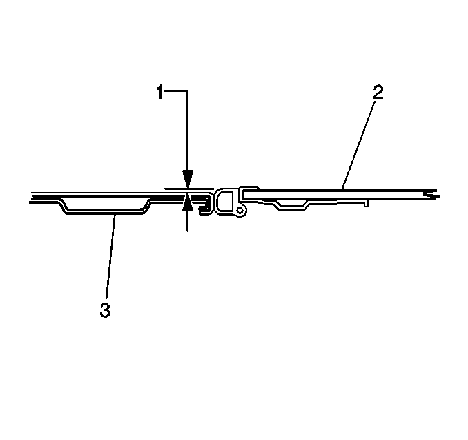

Sunroof Window Height and Opening Fit Adjustment
Cycle the sunroof window from the full open to closed position.
Loosen the 4 adjusting screws (1).
There are 2 adjusting screws on each side of the sunroof window
Center the window front to rear in the opening.
Adjust the front of the sunroof window (2) from flush to 1 mm (0.04 in) (1) below the top surface of the roof panel (3). Tighten
Tighten the front sunroof window adjustment screws to 5 N·m (44 lb in).
Adjust the rear of the sunroof window (2) from flush to 1 mm (0.04 in) (1) above the top surface of the roof panel (3). Tighten
Tighten the rear sunroof window adjustment screws to 5 N·m (44 lb in).
Cycle the sunroof window through all of the positions.
Verify the sunroof window fore/aft adjustments.
Verify the front and rear height adjustment.
Readjust the sunroof window, if necessary.
