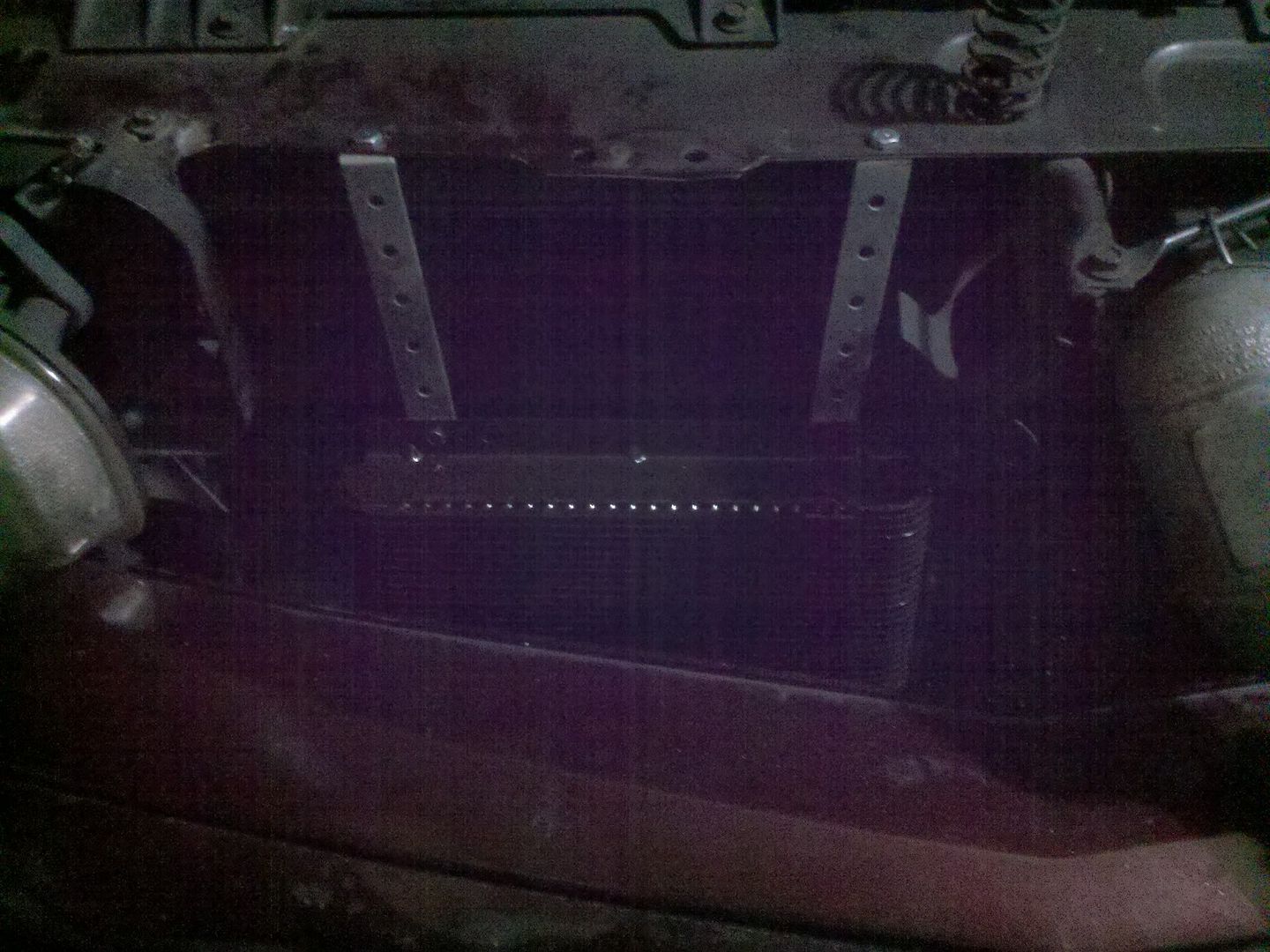

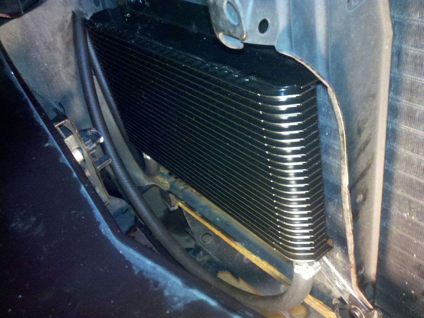

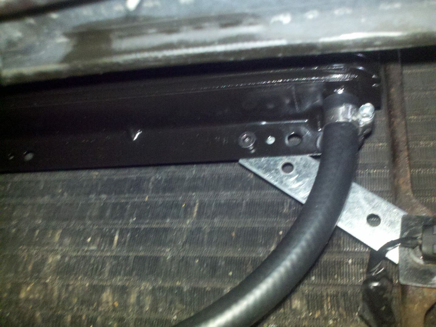

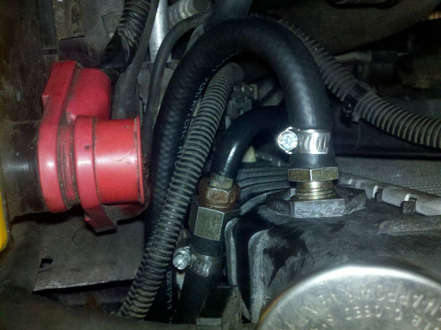

I could not find a valid consensus in my research, but I followed the orientation on the 96 and had both ports facing down. I know at least most of it filled since I could feel it getting warm and I had to add almost half a quart, so I think the flow got most of the air out. Here are the pics, the left hose is pretty snug, but no kinks. Ill probably spray paint the brackets:

Not bad!
A refinement you might want is to put some flexible cable conduit over the hoses as protection from road debris.
